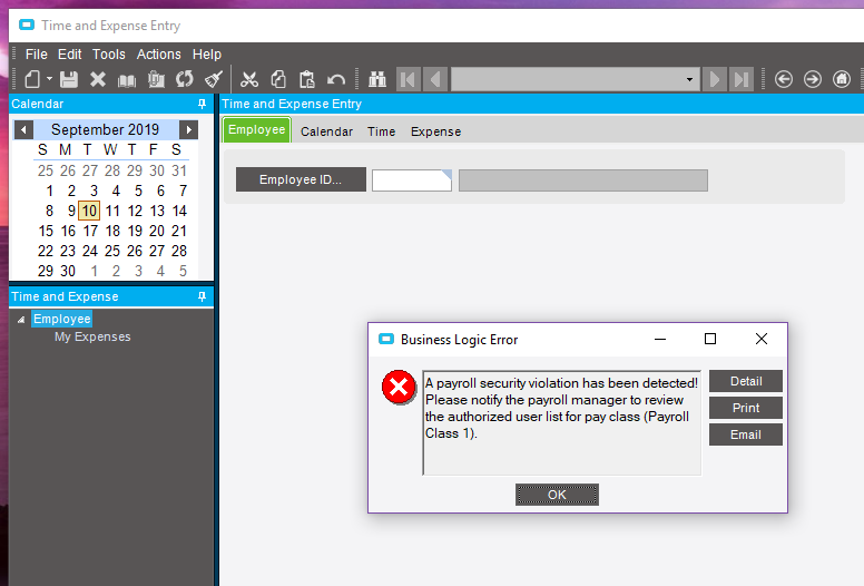

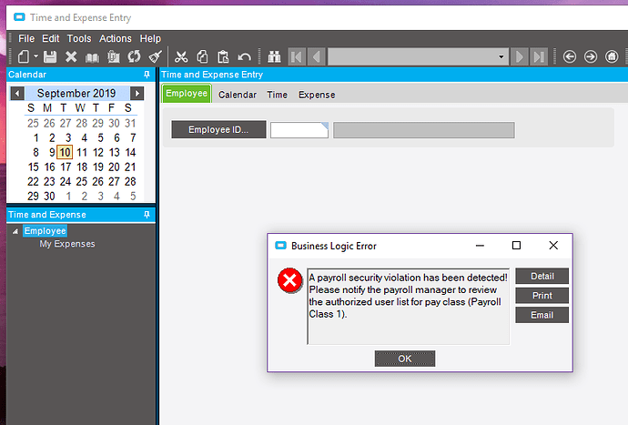

We are currently upgrading from 10.1 to 10.2. Users are doing acceptance testing in upgraded test environment and keep getting this error when accessing Time and Expense entry, or User Account Maintenance.

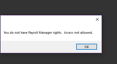

When I log in with the manager account to try to view payroll class, I get this error, even though account security says I have access to payroll module. Do I need to go through an additional step to get Payroll Manager access? The manager account has access to all groups in User Account Security.

Turns out this is a documented issue and I was able to resolve within the Conversion Workbench. There is a Knowledge Base article detailing how to fix - KB0048003.
