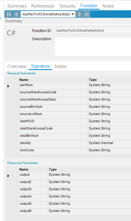

I cleaned up your code and put it in a function.
Hopefully this will be clearer what’s going on.
wuwenben2.efxb (4.7 KB)
Function Code:

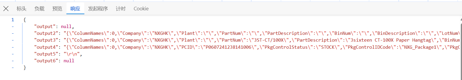

Function Output:
  "output": null,
  "output2": "{\"ColumnNames\":0,\"Company\":\"NOPE\",\"Plant\":\"\",\"PartNum\":\"\",\"PartDescription\":\"\",\"BinNum\":\"\",\"BinDescription\":\"\",\"LotNum\":\"\",\"LotTrackedPart\":false,\"SerialTrackedPart\":false,\"OnHandQuantity\":0.0,\"SourceQuantity\":0.0,\"AvailableQuantity\":0.0,\"WarehouseCode\":\"\",\"WarehouseDescription\":\"\",\"SourceUOM\":\"\",\"AvailableUOM\":\"\",\"OnHandUOM\":\"\",\"AttributeSetID\":0,\"AttributeSetShortDescription\":\"\",\"AttributeSetDescription\":\"\",\"EnableAttributeSetSearch\":false,\"PartAttrClassID\":\"\",\"PartTrackInventoryAttributes\":false,\"DispNumberOfPieces\":0.0,\"PartTrackInventoryByRevision\":false,\"RevisionNum\":\"\",\"SysRowID\":\"2bb04325-da95-47b5-99b4-e71837c5aa95\",\"RowMod\":\"A\",\"SpecifiedProperties\":\"AQAADA==\",\"UserDefinedColumns\":{}}",
  "output3": "{\"ColumnNames\":0,\"Company\":\"NOPE\",\"Plant\":\"\",\"PartNum\":\"048700-0400-011\",\"PartDescription\":\"60 x 22 x112  4 MIL  (25 bgs/roll) MS-1420 (5600022-0050)\",\"BinNum\":\"WARE\",\"BinDescription\":\"Warehouse\",\"LotNum\":\"10171413\",\"LotTrackedPart\":true,\"SerialTrackedPart\":false,\"OnHandQuantity\":19.00000000,\"SourceQuantity\":5.0,\"AvailableQuantity\":19.00000000,\"WarehouseCode\":\"FIN\",\"WarehouseDescription\":\"Finished Goods\",\"SourceUOM\":\"BG\",\"AvailableUOM\":\"BG\",\"OnHandUOM\":\"BG\",\"AttributeSetID\":0,\"AttributeSetShortDescription\":\"\",\"AttributeSetDescription\":\"\",\"EnableAttributeSetSearch\":false,\"PartAttrClassID\":\"\",\"PartTrackInventoryAttributes\":false,\"DispNumberOfPieces\":0.0,\"PartTrackInventoryByRevision\":false,\"RevisionNum\":\"\",\"SysRowID\":\"2bb04325-da95-47b5-99b4-e71837c5aa95\",\"RowMod\":\"A\",\"SpecifiedProperties\":\"/f//Dw==\",\"UserDefinedColumns\":{}}",
  "output4": "{\"ColumnNames\":0,\"Company\":\"NOPE\",\"PCID\":\"5012379\",\"PkgControlStatus\":\"STOCK\",\"PkgControlIDCode\":\"PALLET\",\"PkgCode\":\"PALLET\",\"PkgControlIDDesc\":\"Pallet\",\"WarehouseCode\":\"FIN\",\"PreviousPCID\":\"\",\"Plant\":\"MfgSys\",\"PkgCodeDescription\":\"Pallet\",\"BinNum\":\"WARE\",\"BinDescription\":\"WARE\",\"WarehouseDescription\":\"\",\"PCIDContainsChildParts\":false,\"PCIDContainsChildPCIDs\":false,\"BinNumEnabled\":false,\"SerialNumberTracking\":false,\"SysRowID\":\"00000000-0000-0000-0000-000000000000\",\"RowMod\":\"A\",\"SpecifiedProperties\":\"f48H\",\"UserDefinedColumns\":{}}",
  "output5": "\r\n",
  "output6": null

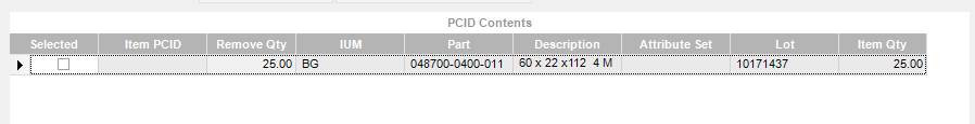

I tried the code you gave me, but it didn’t work :face_with_monocle:
It’s not the code that doesn’t work. Something is wrong with what you are sending it.

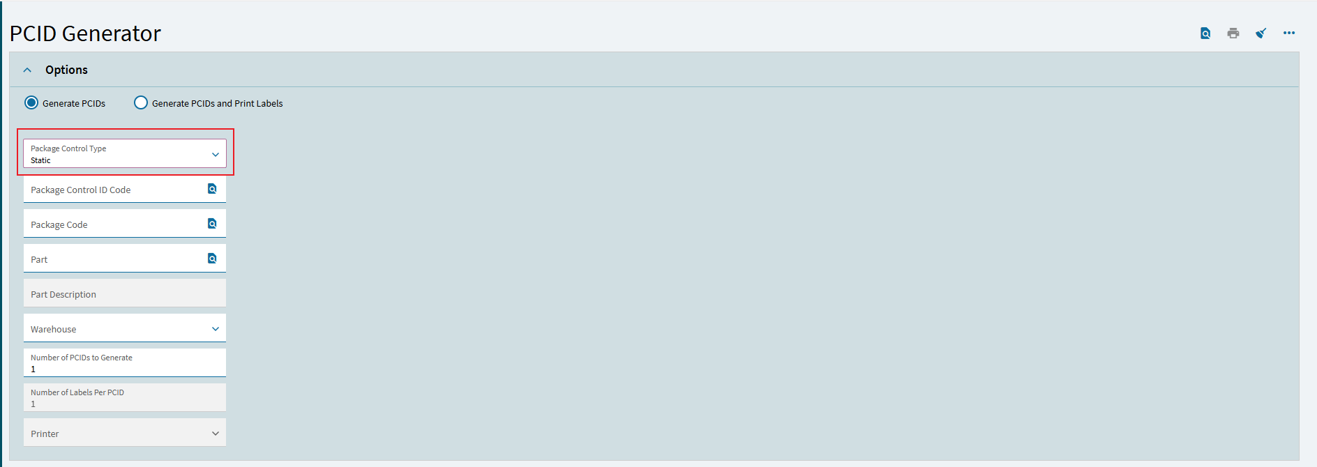

I tried your code again

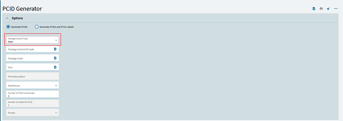

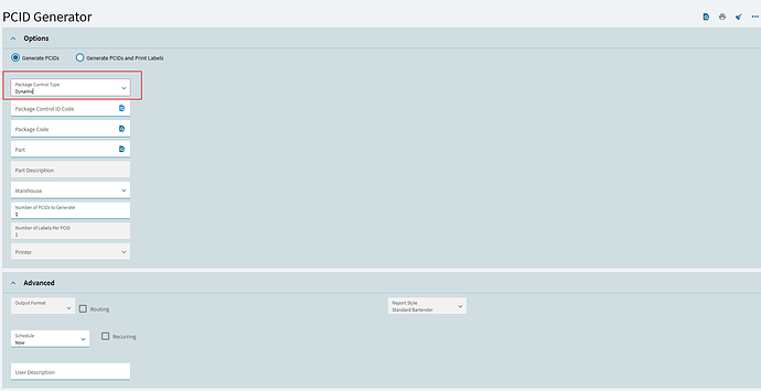

AddPartToPCID is valid for static generated PCID
AddPartToPCID is invalid for dynamic generated PCID :broken_heart:
Don’t know what’s going on with yours. All my pcids are dynamic.
