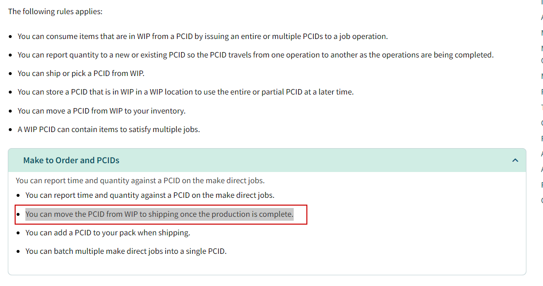

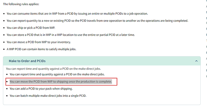

We found this article also, that is why we have been working on it for 3 months - we have had NO Success. We did COMPLETE the Make Direct Job but Customer Shipment Entry would NEVER find the PCID - the Message says:
“You cannot pack this PCID unless it is picked or have a statue of STOCK”
We have found there are 2 sets of tables for PCID’s:
Make to Stock go to PKGControlHeader link to PKGControlItem and have a status of “STOCK”
Make Direct go to PKGControlStageHeader link to PKGControlStageItem and have a status of “STAGE”
We are thinking EPICOR did not finish the programming to look at the Make Direct PCID Files when the item was Make Direct.
Error is:
“You cannot pack this PCID unless it is picked or has a status of STOCK.”
