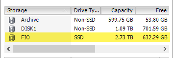

Storage looks good. Archive is just a repository for SQL backups.

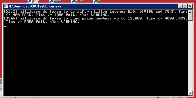

Still sitting at 13k+ after the host reboot.

By the way the upper number 5182, I got that off the Epicor PDT Test but its not displayed anywhere so when it says >= 1000 FAIL, I usually ignore the upper reading, I never have gotten that to pass, perhaps Epicor just uses it as a ā€œwarmupā€ because the 2nd number 3546 is the one that is displayed on PDT :slight_smile: FYI if anyone is wondering. If anyone uses the tool, just focus on the 2nd reading.
