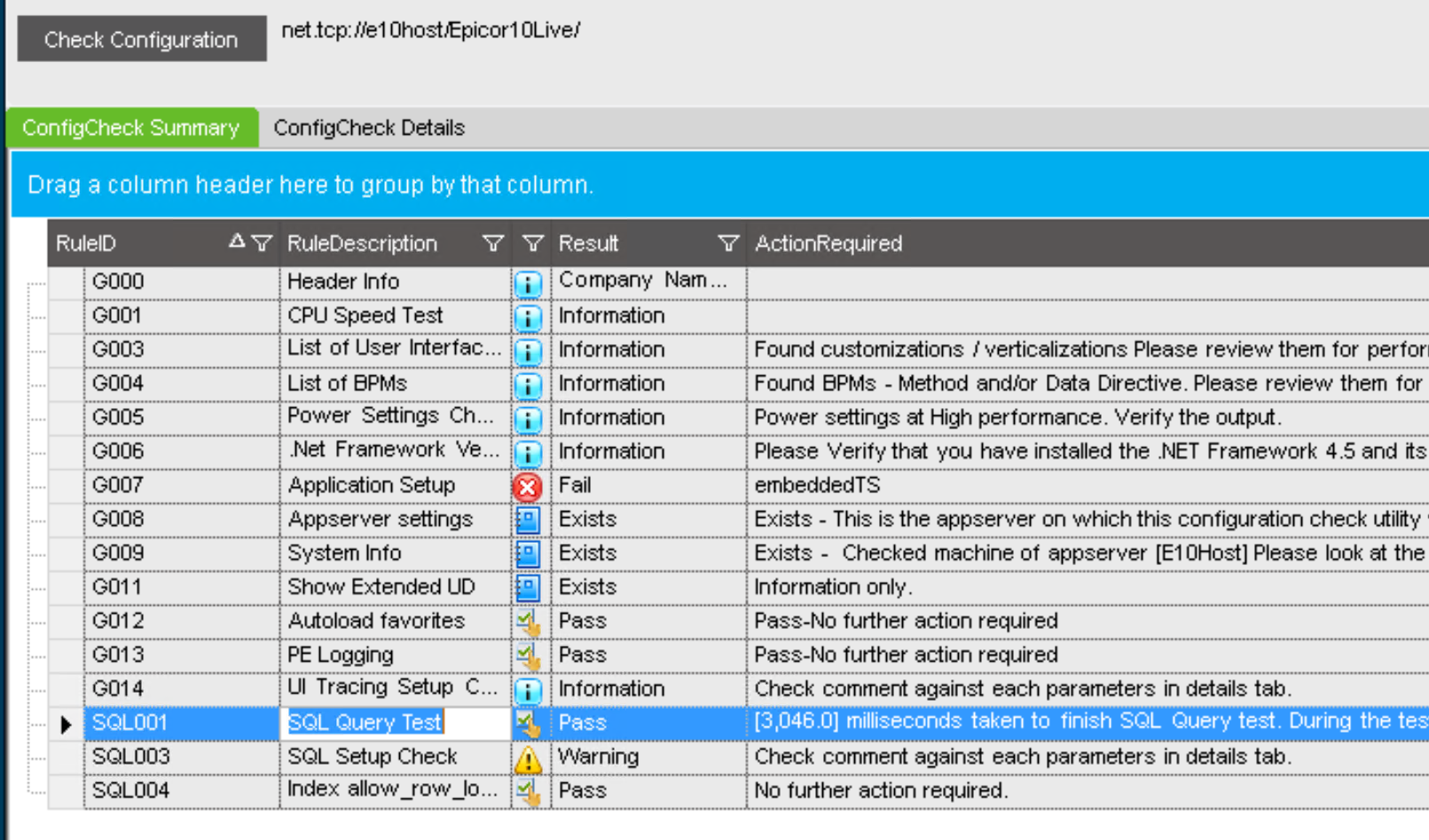

The primary complaint about Epicor(we’re running 10.2.400 on prem), is that it’s slow. It’s to the point our engineering team won’t use the system unless they have to, or they go out of there way to design webpages by querying(read only) the SQL DB directly as it’s significantly faster than the client to access the information. I’ve run the PDT tool and we are passing performance benchmarks, but I do notice we’re “marginally” passing the SQL Query Test. The screenshot below it completed in ~3 sec which is the fastest I’ve seen. We’re generally right around 3.5 sec(the threshold). Keep in mind we ~8-10 users on the system usually for context. In practice for a snappy system what is “good” performance for the SQL Query Test(I think Haso told me he sees around 2 seconds…)?

Just ran PDT and scored 2,000 on that test. This is a SQL test, so the most relevant part of the system would be BAQ’s and Retrieve buttons…and those are responsive.
Where the system seems to bog down is in the client UI and some of the biz-logic heavy posting processes. I lack the time and background to diagnose the causes of that, but I doubt it’s data retrieval that’s causing issues.
Thanks! This is helpful as we are working through the server sizing guide to ensure we are meeting minimum specs with a goal of reaching “reasonably good performance”. In this case it sounds like 2 seconds is an attainable goal for us to shoot for!
