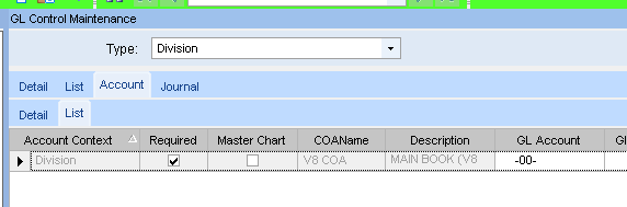

Here’s what I have:
Company Config form
Inventory COS and WIP
type, whose GLC code has GL accts specified for all required Contexts
Site Config form
- No GLC’s
Site Maintenance form
- All sites have a GLC of type
Division
setup. GLC Codes similar to:
with different division #'s for the different sites (-00-, -11-, -16-, etc…)
Warehouse form - none of the warehouses, on any site, have any GLC’s setup.
Should I have GLCs for Company, Site, and Warehouse? The warehouse ones would be identical to the Company ones.
