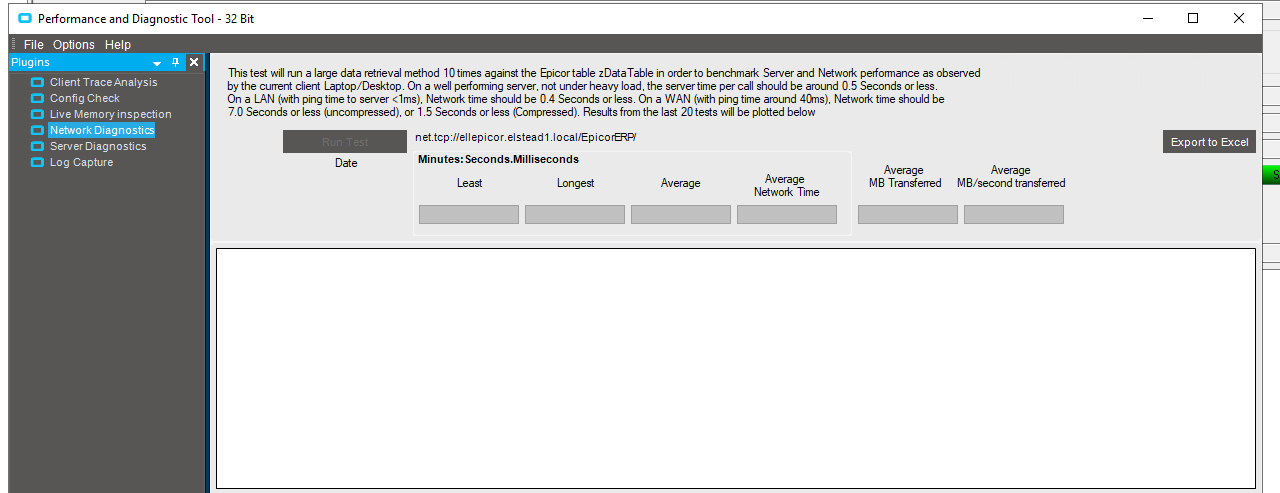

Hello I cant get the epicor analyser to work for the network test its just greyed out
You have to go under Options and configure a connection first.
Do they still have PDT for kinetic?
Yes, it is still all server side. It calls a BO on the Server.
