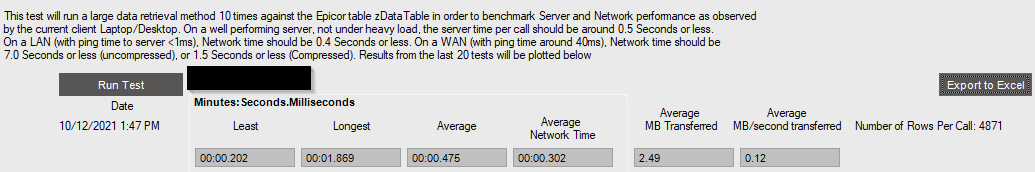

It does not appear to be network related. When looking in our Silverpeak, the packets are being sent and returned in milliseconds. Speed test in both locations 80+mbps upload and download. Also, here are my results for Network Diagnostics from the PDT tool, ran from my machine in Iowa to the CT application server.
