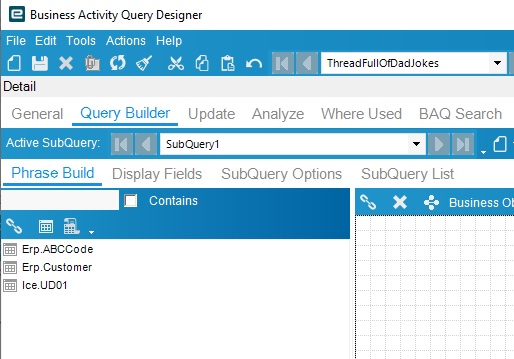

Restricting Tables in the BAQ Designer (Example)
Note this code is not complete, as you would need to add in the security checks,
and also, need to do the basically the same thing on the BO Table List etc…
But anyway, two approaches. Allow & Deny
Allow:
//Method Directive Post-Processing on Ice.BO.BAQDesigner.GetTableList
//Allow List
List<string> allowedList = new List<string>()
    "Erp.ABCCode",
    "Ice.UD01",
    "Erp.Customer"
List<FullTableListRow> onlyAllowedTables = result.FullTableList.IntersectBy(allowedList, x => x.FullTableName).ToList();
result.FullTableList.Clear();
result.FullTableList.AddRange(onlyAllowedTables);
Deny:
//Deny List
List<string> denyList = new List<string>()
    "Erp.PartTran",
    "Ice.Menu",
    "Erp.Customer"
List<FullTableListRow> onlyAllowedTables = result.FullTableList.ExceptBy(denyList, x => x.FullTableName).ToList();

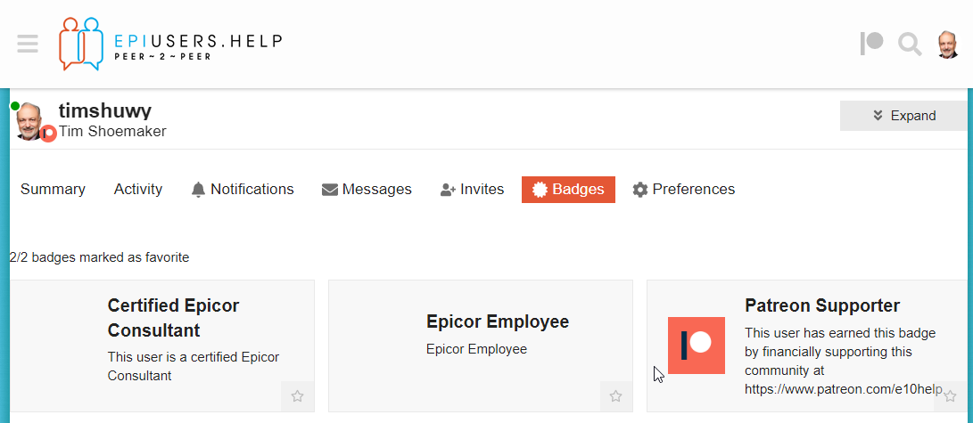

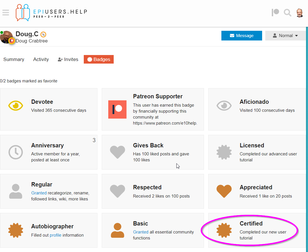

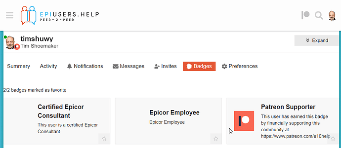

According to some organization that I belong to (called epiusers.help), I received a badge that called Certified Epicor Consultant… So, i guess I am certified!
@Doug.C don’t laugh too hard… according to Epiusers.help, YOU are certified too:
