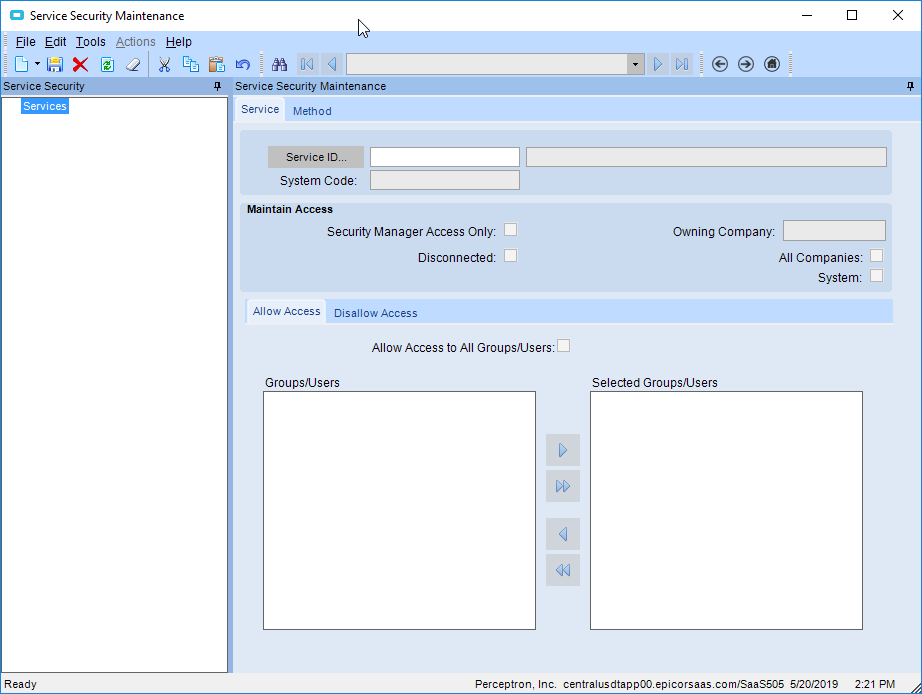

We give Journal Entry to several people but only allow the journal “approvers” to post the entries. That gives us some level of separation. We use Service Security to do this.

What is security service?
So you set the method different for approvers?
Yes. The default is All Users but I set the Post method to all allow {compID}-canPostJournals - a security group that has the approvers in it.

Is this feature available in 10.1.400?

I think so but it might be called Method Security.
