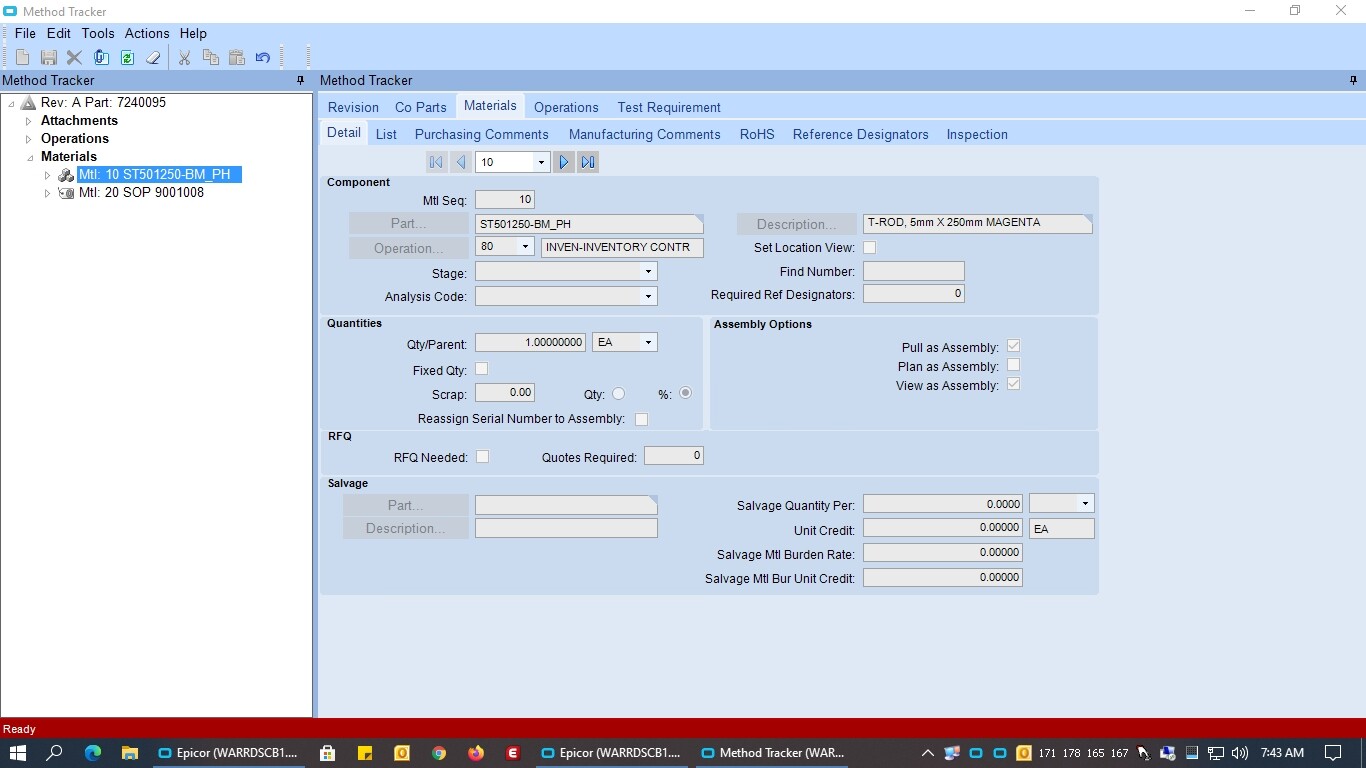

So we have gone Live in E10 and now our Phantom BOM’s are not blowing through to the components when we create Jobs like they did (and still do) in our Pilot/Test environment. Any Ideas to help here? I did notice that in our Pilot environment. the Pull as Assembly box in the MOM is check and it is not in Live, so I changed a MOM in Live to mimic this and it did not blow through but put in in as a subassembly on the Job. I have submitted a ticket to our helpdesk but thought I would check here too.
Check the site tab on the part record. That’s the flag that actually controls it. The one on the general tab is supposed to control them, but sometimes they get out of sync.
Thanks for the info Brandon!!
@Banderson, @MRoether - just a clarification… the fields on the front detail tab in the “Site Defaults” section are just that… DEFAULTS… for when you add a new site. In some cases, if you change the site default, a pop-up will be displayed asking IF you want the sites updated…
But in all cases, the actual value on the site tab ALWAYS wins!
