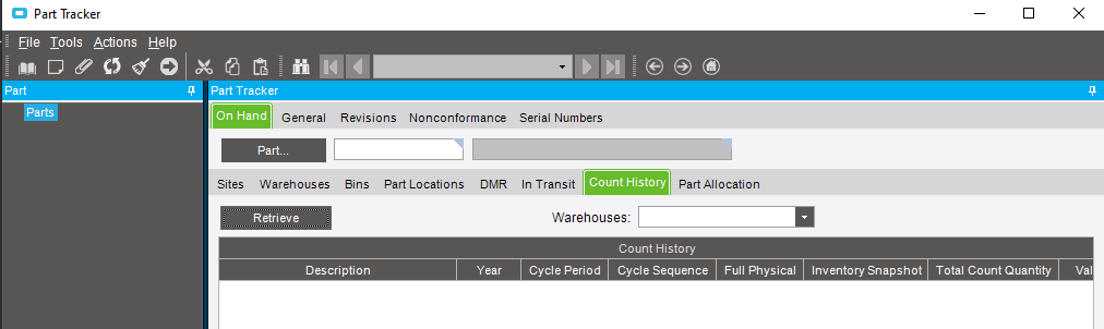

How do you find an un posted Cycle Count Group? We have a part that the system will not allow us to Cycle because it is assigned to another open group.
You should be able to see all incomplete Cycles from Cycle Maintenance:
Then, sort by Cycle Status
And if you know the part number, use Part Tracker:
Thank you, I found them!
