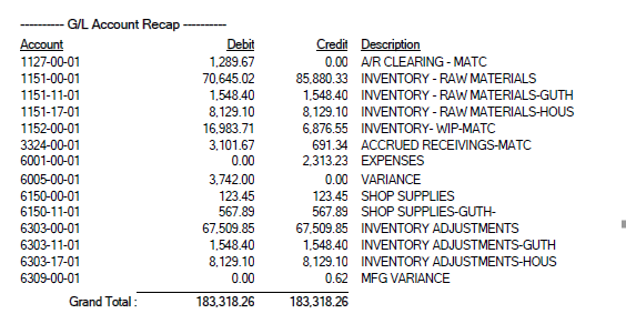

The Capt COS/WIP process allows you to enter a cutoff date that effectively does that. But that is playing with fire. If someone forgot to set it correctly …
On the plus side, the WIP Recon Report will show you the summary of the GL transactions that will be created.
For example Running WIP Recon (Actually called “Inventory/WIP Reconciliation” ) with a date range of 4/1/2016 - 4/30/2019 (notice the start date is 3 years ago), and only unposted Transactions, shows about 10 pages (about 300 transactions), abd the summary of
So you’d only have to make 1 JE for the 15 accounts shown, to “undo” the effect of this one-time “catch-up” Cap COS/WIP processing. And a lot of those netted to zero (like the 5 of the bottom six. Accts 6150-00-01 thru 6303-17-01)

Thanks for the April fool’s warning @ckrusen, I decided to run the recon last night. 25 thousand pages resulted! The last page (like your image of the G/L Account Recap) is the significant page, BUT… Epicor won’t attempt to post 25K pages worth of inventory adjustments to my GL, will it? The Rollup that you mentioned should trim that down significantly(??). Now I’m concerned!
