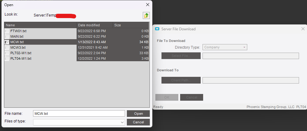

Epicor generates a log file when you post counts that should give you some information about why that particular part didn’t post. You can use the Server File Download function to find the file under Directory Type: Company and in the /Temp/[username] folder.
