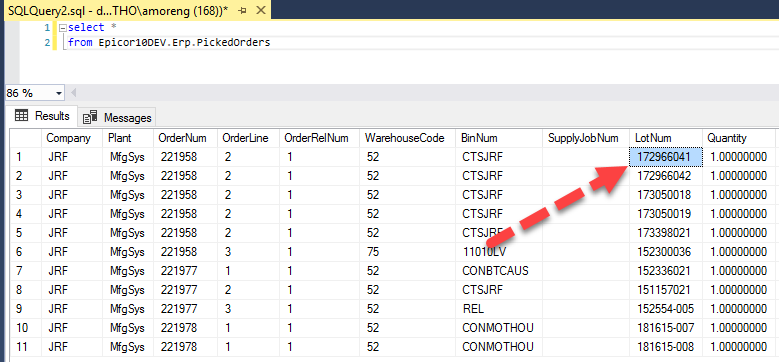

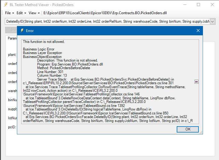

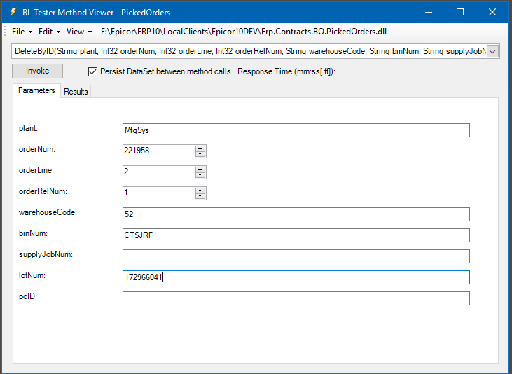

Using the BL Tester, when I enter the info to DeleteByID, it’s throwing an error when I delete the record but it still performs the delete:
SQL (record count is 11):
BL Tester:
Error:

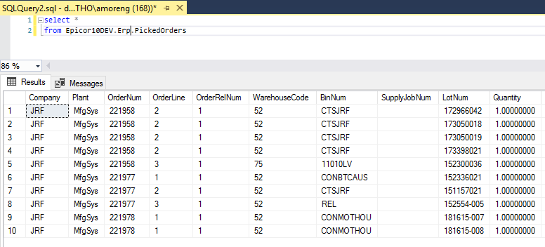

SQL After (Record is gone and new record count is 10)
This is goofy as heck and I’m wondering if it’s safe to implement in the code…
EDIT: tried this function through the API and it returns the same error yet also deletes the record
Clearly some error in the Epicor code with this.

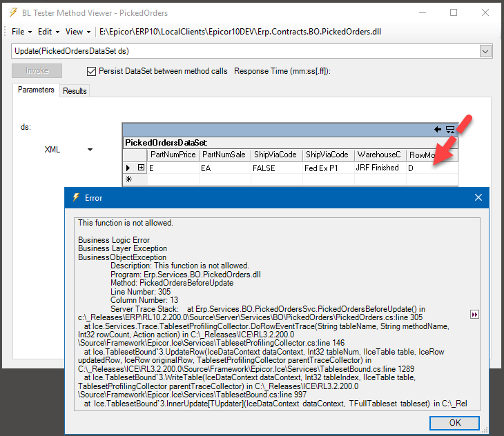

I tried a GetByID to return the dataset and then I set the RowMod to D. When invoking Update, it throws a very similar, if not the same, error. In this case, it doesn’t delete the SQL record
Okay - so there you go… BO does not allow Delete and you have identified an error in the DeleteByID logic. Sounds like time for a cool adult beverage.

For what it’s worth - i know it’s already been determined, but the decomp for that service does in fact show that all Deletion functions are explicitly written to throw that exception. For that matter, the Update() function is the same.
