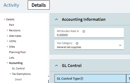

You can set burden as a % in the Part > Accounting menu, but I’m not sure how you might go about doing that in a non-linear way. I don’t believe I’ve seen costing “breaks” like with labor, but I might be mistaken on that.

Blockquote You can set burden as a % in the Part > Accounting menu…
Is that in Kinetic only? I only see the option to set GL Controls.

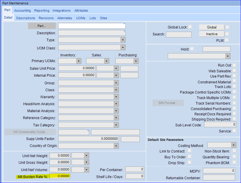

Yep looks like they moved it from the main Details tab to the Accounting tab in Kinetic
