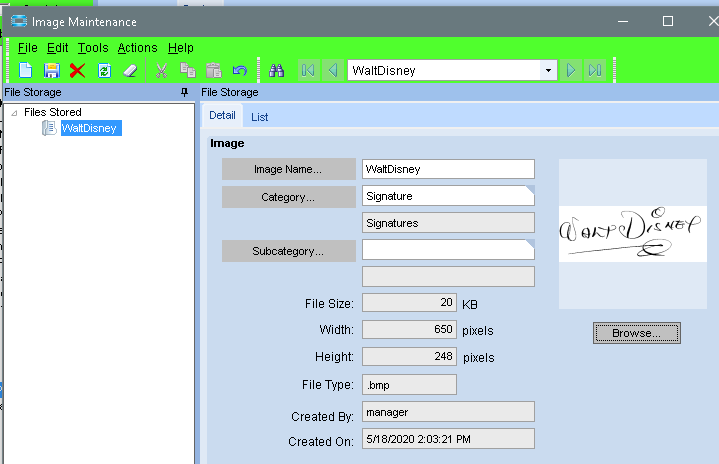

The source of an image must come from an image setup under Image Maintenance.

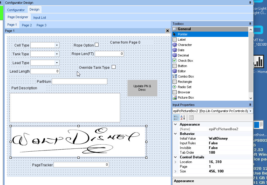

And here it is in a configurator Designer.
Then refere to the images ID that was used in Image Maint.
if(Inputs.ucbCellType.Value != "CU4"){
Inputs.epiPcPictureBox2.Value = "Logo";
else{
Inputs.epiPcPictureBox2.Value = "WaltDisney";

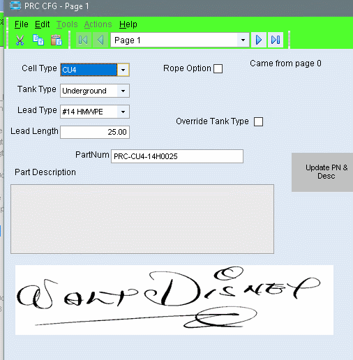

Here it is in action:
WOW! Thank you for the detailed information! It doesn’t look like you can URLs though, correct? I can use, and see, these with the browser tool, but the sizing is a nightmare so far.
Yeah, the sizing is an issue. Unlike images in SSRS reports - where you can specif how to handle it (scale, stretch, clip, etc…), the Pict Box in Cfg Entry always stretches the image to fit.

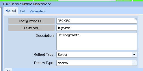

I couldn’t query the Image table directly in Configurator Designer event code. But I could make a User Defined Config Method, that could fetch the images dimension.
I had problems passing the ImageID to the Method, so I just made a textbox control on the Confg Entry to hold the ImageID. Then referenced that controls value in the UD Method code.
// Enter valid C# code and do not forget this method returns an integer value.
return Db.Image.Where( r =>r.ImageID == Inputs.txtImageID.Value).Select( r =>r.Width).FirstOrDefault();

Correction to the post above. My UD Method specified a return type of decimal. Should have been int.
