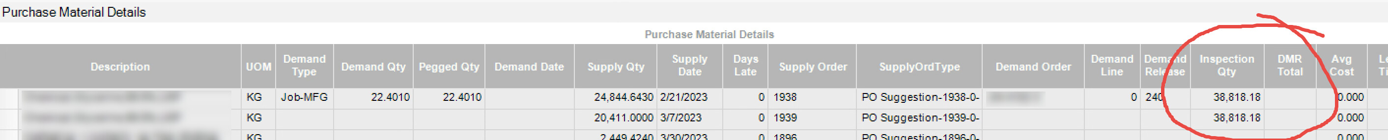

We are having problems with non-conformance parts not showing up as “On-hand quantity” while they are pending inspection, leading to new PO suggestions to purchase more of the given part as soon as possible despite the possiblity that the non-conforming parts will return to inventory. Parts that go directly from PO receipt to Inspection (PUR-INS) do show up as on-hand quantity in Time Phase and Part On Hand Status (Under “Receipt Inspection”) while in Inspection, but nonconforming (STK-INS) parts do not (they show up under “Nonconform. Inspection” within Part On Hand Status but not Time Phase).
Is it possible for non-conforming inventory to be handled the same as Receipt Inspection parts, such that they are considered “On Hand” inventory but still quarantied not available?
