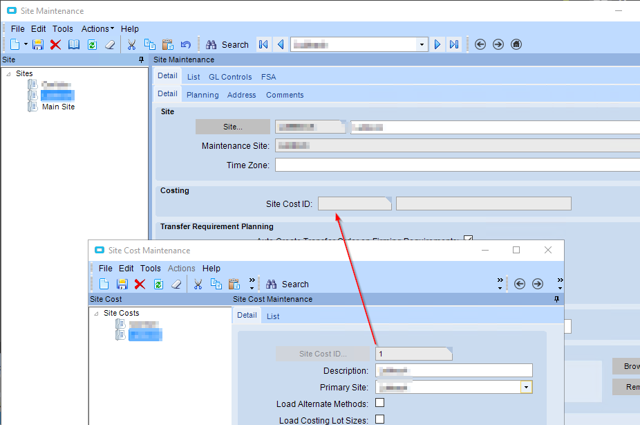

After a copy to a new company of E10, I have an empty value in Plant.PlantCostID for one of the sites. I tried changing the site to MfgSys in Site Cost Maintenance, saved, and changed back to the original site, but the value remains empty.
PlantCostID is a read-only field.
Ideas?

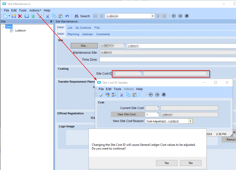

In Site Maintenance, there’s a command under Actions:
I think we used this after our upgrade from 10 to Kinetic.

So, I’m about to push the button on the fix, but get this message:
I’ve checked the costing in PartTran and PartCost and it looks like it’s doing the average costing correctly to the right cost ID.
What mushroom cloud might I expect when I change the cost ID from empty to 1?
Thanks,
Joe

I just did this recently and so far finance have not reported any issues.
Will do it now.
Thanks for your reply Daniel.
I got the finance team to trial in Pilot environment first. They ran a TB and then i processed the action and they ran a TB after to make sure no costs changed.
