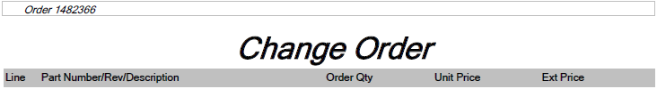

For PO’s… you can print the PO “as Changed”. There is a flag on the standard SSRS to control this: POHeader.PrintAs
Out-of-the-Box PO will then print with a HUGE “Change Order” Status in the middle of the page.

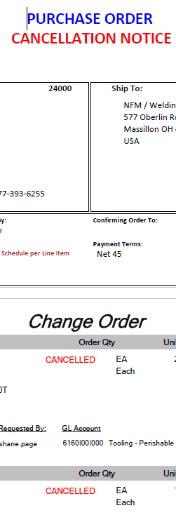

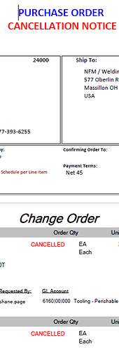

For Cancellations… we created a custom report style. So, yes, the Buyer has to specifically print this style… but it looks something like this:
Cancellation marked on top and on every line item.

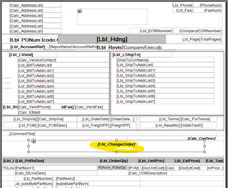

The base SSRS POForm has a row containing the “Change Order” alert. Its minimized, so difficult to find unless you stretch the row height, but it is underneath the order Comment Text:
It is very possible whoever customized your form got rid of that row/textbox… but the field and functionality should probably still exist.
Below is the expression in that textbox:
=iif(Fields!PrintAs.Value <> "C", "", Fields!RptLiteralsLChangeOrder.Value)
Basically, if that POHeader.PrintAs value does not equal “C”, then it displays nothing. If the value = “C”, then it shows the “Change Order” text… the row is allows to grow and it pops into the middle of the form.
You could easily add that back in, if it was removed from your customized form.
thx David, i found that, will add it now to the customized form
