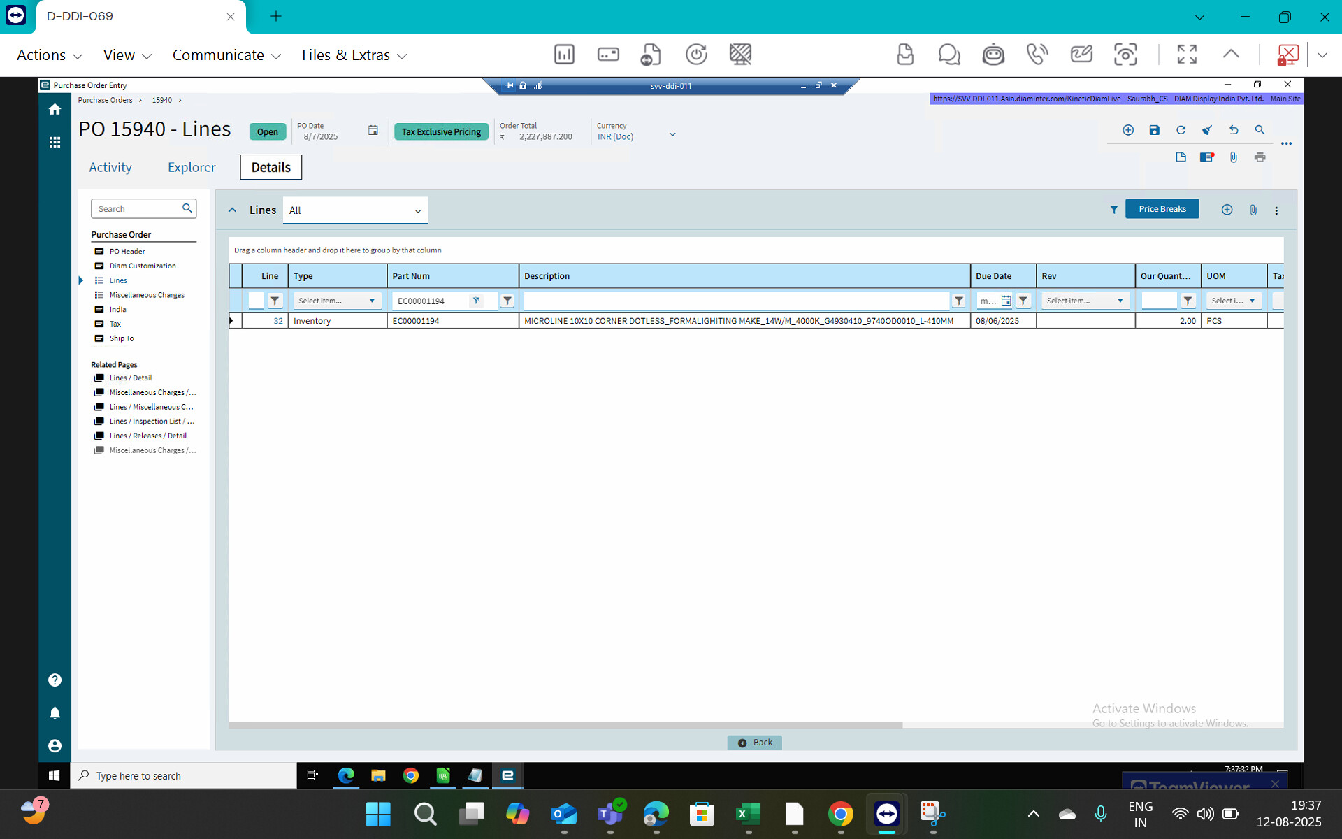

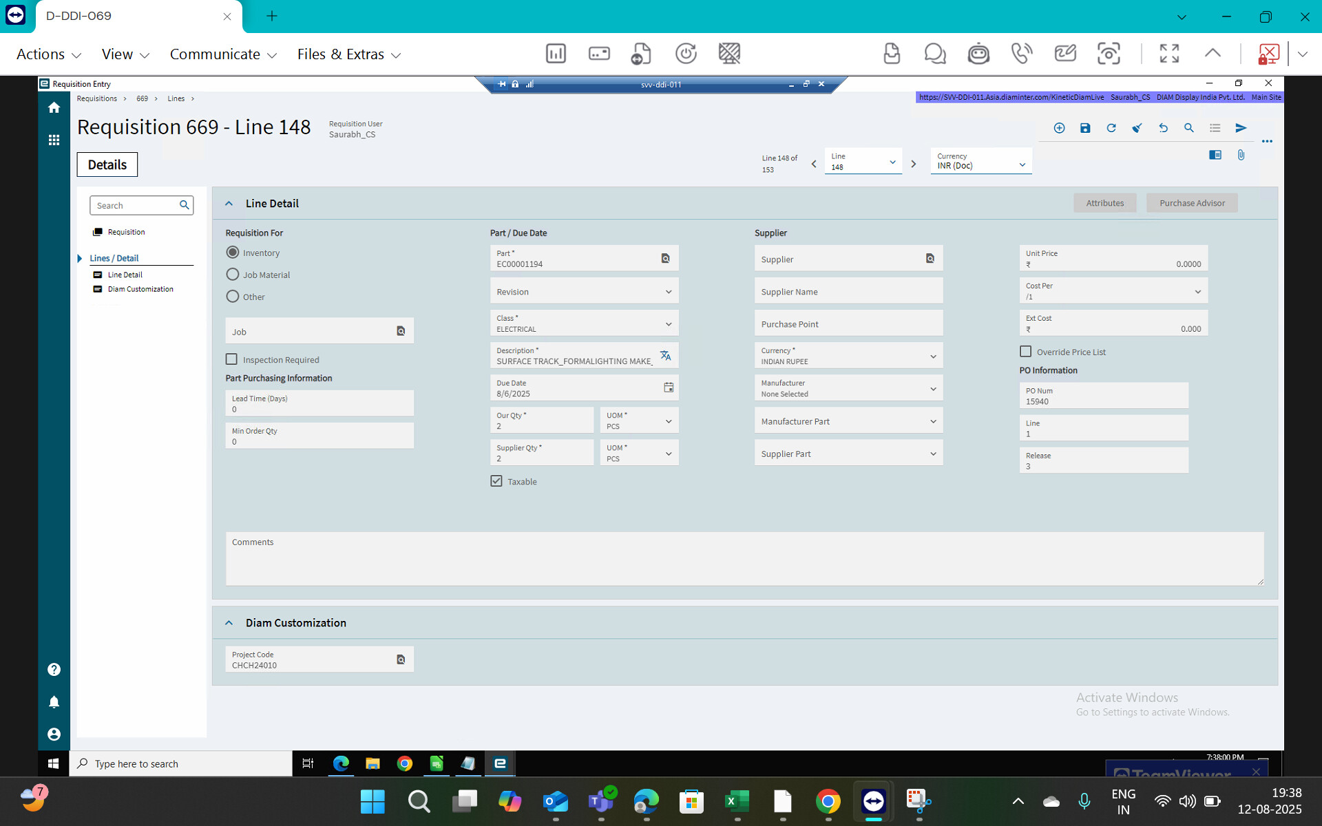

when i am creating req entry and then from po suggestion i am creating po then in the newly created po in epicor kinetic part desc gets changed automatically. in req entry the desc is same as in part master but when po is generated then desc is of another part . how to solve this in epicor kinetic.. This issue i am facing in live

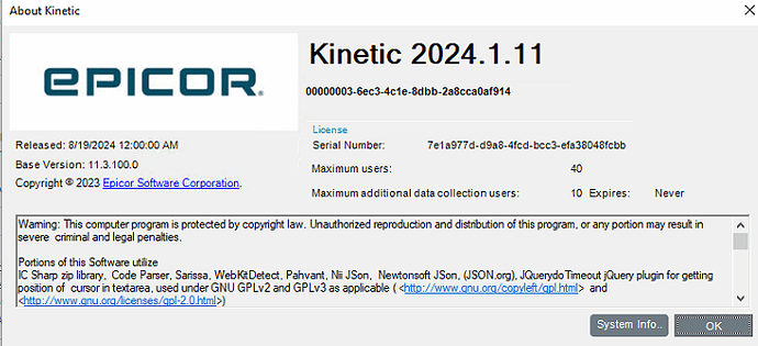

using this version of epicor.Kinetic 2024.1.11 and version 11.3.100.0

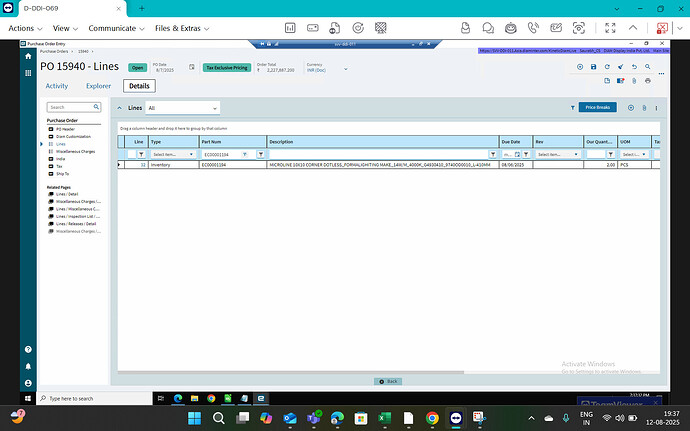

This is my PO part desc.
This is my req part desc

hi from your screenshot, the PR line 148 converted to PO line 1 rel 3 while your PO screenshot is line 32
