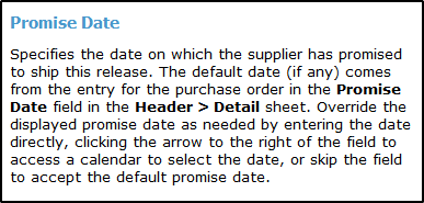

Promise date is the date the supplier is supposed has promised to ship it.
Due date is when you need the product to arrive.
Who cares when they ship it? All that matters is when it will arrive.
Promise date is a glorified CONFIRMED box. Does nothing outside of telling you that the supplier has given you a date.
