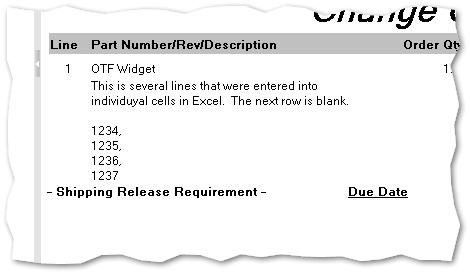

Well the rabbit hole just got deeper… I was given a PO from May that printed correctly and tried that PO number using the base report style and it was on multiple lines. I tried it using the modified report and now each line is double spaced, so the solution does work but the question is why does the new way they are entering data cause it to be on one line vs what they did in May. UGH!

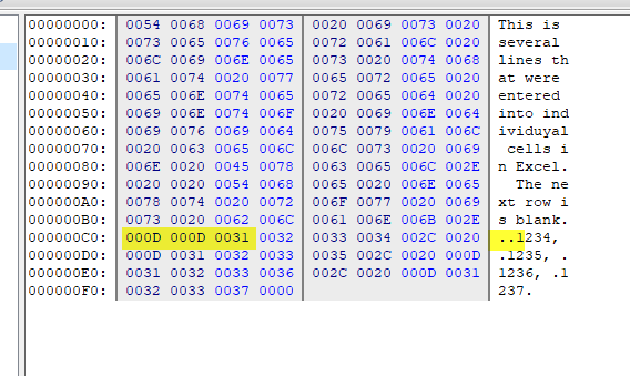

Your getting the double space because when the field already has CRLF, your replacing it with CRLFLF.
The inner replace changes CR to CRLF, and the outer replace replaces CRLFLF with CRLF.
Hello[CR]World! becomes Hello[CR][LF]World! Hello[LF]World! stays Hello[LF]World! Hello[CR][LF]World! becomes Hello[CR][LF]World!,
… by first becoming Hello[CR][LF][LF]World!
… and then becomes Hello[CR][LF]World!
Thank you! that script works perfect and both the previous May PO and new Nov PO print the same way. I could not find any difference between the two in how the description is entered.
