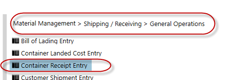

Try using this.

Thank you Craig. Unfortunately we do not want to use Container Receipt Entry as the release/line should not be linked to the container.
