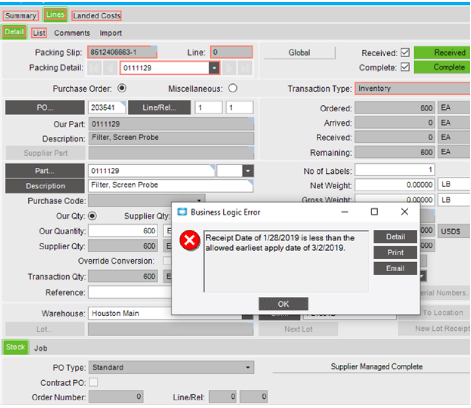

Anyone knows how to fix this error? Thanks.
Somebody set the Earliest Apply date to 3/2/2019 so you can’t do any transactions dated before then. Financial Management -> General Ledger -> General Operations -> Earliest Apply Date is where this is set.
Earliest Apply date is set in Accounting. It will not allow you to make transaction less than that date. Considering it is 1/28/19, accounting needs to change the earliest apply date.
