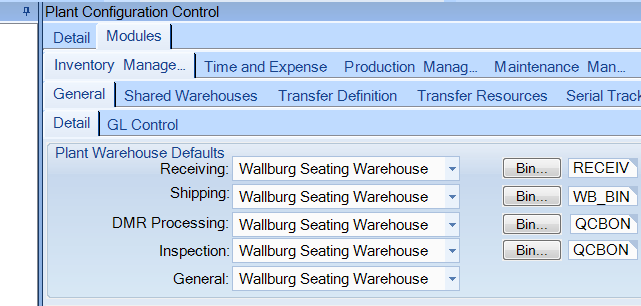

We have multi-plant setup, but each plant only has one warehouse. I think you’d select the specific warehouse on the Release tab.
FWIW - the plant you launch the PO Entry from, becomes the default plant & warehouse for that PO. If I launch PO Entry from Plant A, but want the items to ship to Plant B, you have to change it on the PO Header. Or on the Release, if you want different items to go to different plants/warehouses.
