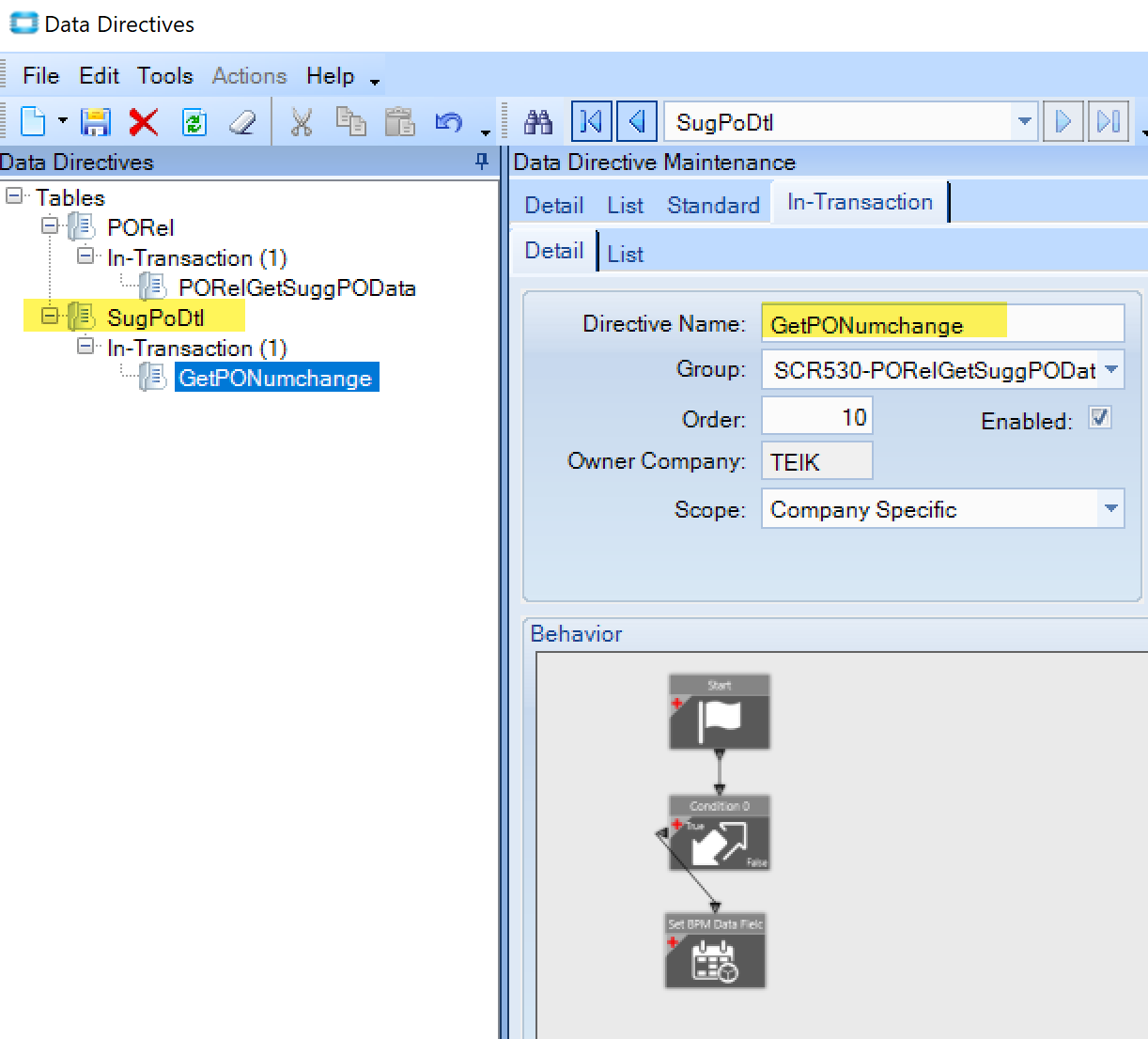

I’m thinking of bpms similar to ours where we store original PO suggestion number in the PO release UD data. Now, you’ll be doing different things with your data, but I think method might work.
We have two data directives, one on in-transaction on SugPoDtl to get and store the suggestion number, then we have another in-transaction on PORel to see if my PO release update is coming from POSuggEntry and if so, stick the stored Sugg num from the BPM data field into the release data and then clear out the BPM Data field. Whaddya think?

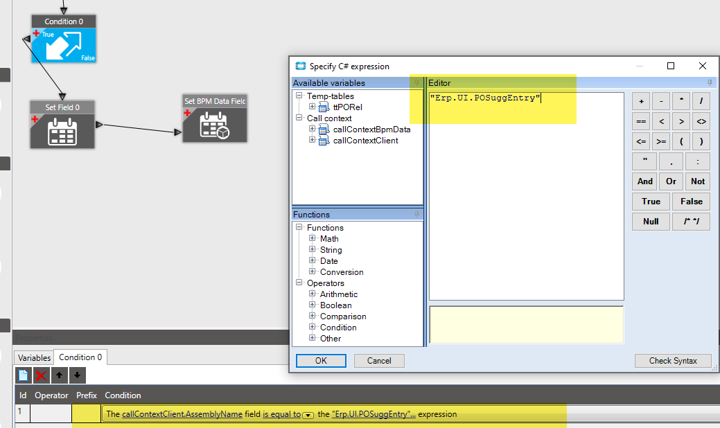

That may work… What is the condition? “ERP.UI.POSuggEntry…” What is the rest of that?

That condition on the second DD bpm is:
Then the first one’s condition is fairly basic on the PO suggestion, just looking at then my changed row has a sugg num, which any new one will have I think:
I don’t think I’ve ever uploaded a file here, let me see if I can figure it out and I’ll attach it.
NancySCR530-StorePOSuggNumOnRelease.bpm (34.0 KB)
