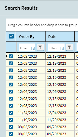

PO Suggestion > Running a search… I select a Buyer to search by… they have multiple suggestions in the search results. I select them all and click okay…
…the search results then populate the dataview/grid on the PO Suggestion screen. Cool!

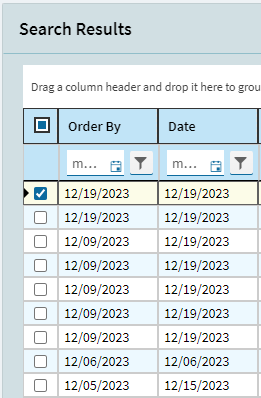

I do the same search… I get the same result set… but this time I only select ONE record and click OK.
This time the dataview/grid on the PO Suggestion page does NOT update.

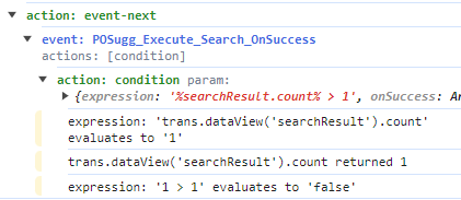

I debugged and noticed the “Condition” on the POSugg search is:
‘%searchResult.count% > 1’
So, if I only select one record and try to load it on the screen, this condition evaluates to FALSE, and the grid does not update/populate with the one selected record.

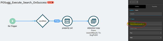

Below is the event from App Studio:
Should this not be: >= 1
With the current “condition” I have to select at least (2) records in the search results for the results to populate in the grid.
