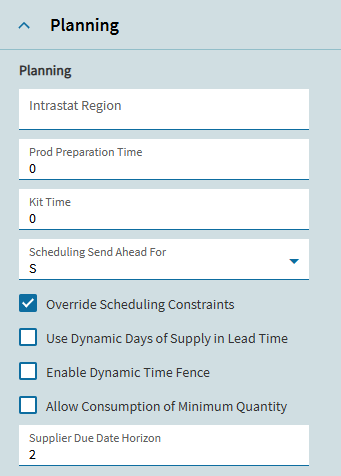

What about Dynamic Time Fence? Both are set to TRUE currently.
Start with the Dynamic DOS and if that does not work, try the Dynamic Time Fence
Do you have a non-zero value for Reschedule Out Time Delta (under part’s Planning or part’s Site Detail)?
Reschedule out Delta No, it is Zero.
@jkane, No change after turning off DDOS.
I would change days of supply to zero just to see what happens. I have had strange results like this too at times. Do you have a supplier price list? What is the lead time there?
I’ll be testing it with Dynamic Time Fence off tonight. Update Friday morning.
@aosemwengie1 I have several parts that are doing this. All with Day of Supply = 20. I’ll also test a couple of them with this reset to ZERO.
Switching off the Dynamic Time Fence worked. Still I’m left wondering why it was only affecting this one Supplier’s parts.
