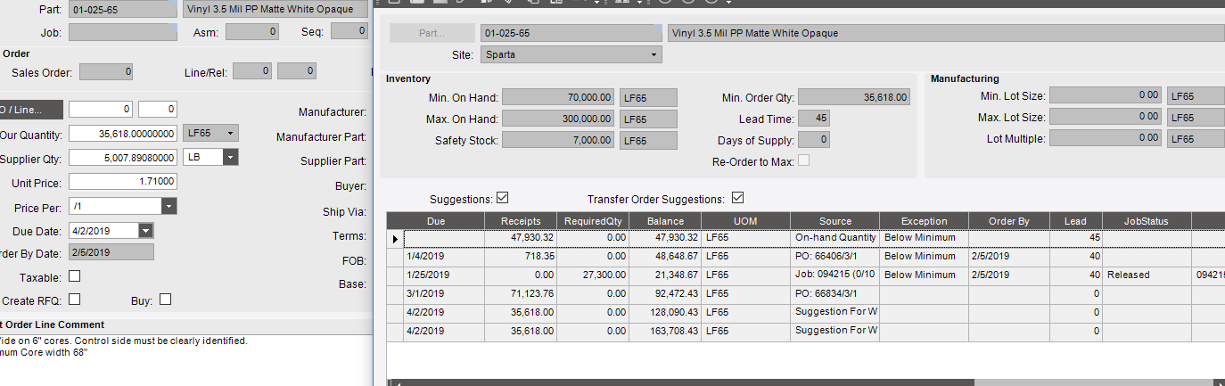

Endlessly frustrated with PO suggestions in E10.0.700.4.
Purchasing here set about getting things lined up with setting mins, maxes, moqs, lead times to ensure all the ground work was laid to have a successful program. After several weeks of playing around and reviewing our purchasing module, we have locked qty and date on POs by default.
Multiple suggestions for the same part with the same due date. See the last two lines of the time phase on the right side window in the pic. Why isn’t a single suggestion for the combined sum being suggested?
Total new suggested POs for today after regen = 69. Once duplicated removed = 53.
Any help figuring this out would be greatly appreciated.
On the Time Phase, expand the Source column to show the entire text.and scroll to right to see if any other columns have values.
One note … Multiple PO’s for the same part will be created if there is are different comments related to it. Like If a part is Buy To Order on separate order lines, and each of those lines has different line comments, it would creat a diff PO suggestion for each. I think this is also true for Buy To Job, and the Mtl on the BOM has different comments.
But these doesn’t appear to be your issue.
I beleive Days of Supply is the value that works to combine purchases. We set ours to 5 so that we only bring in that material once a week.
Thanks Greg! Can you point me in the direction of which “Days of Supply” affects this? There are fields in both Lot Sizing and Short Horizon planning under Part>Sites>Planning.
Also, I was under the impression that the only inputs that affect PO suggestions where Max, Min, MOQ, lead time, and safety stock…
Days of supply in the lot sizing area is the one. Below is from the MRP Tech Guide at the link below. It is a fun read if you have the time :slight_smile: In addition to days of supply there are dynamic Days of supply, which we use to combine orders. Dynamic is set on the Plant record and will reset the days and look out again to combine orders.

Greg, if I’m interpreting that correctly, days of supply is essentially doing the same function as lead time?
Days of Supply refers to how many days am I allowed to have that supply in advance.
If I need the same material on Monday, Wednesday and Friday and have days of supply set at 5 I will get one suggestion to receive the material on Monday and have the supply on hand for 5 days before needed. With days of supply set at zero you will get three suggestions.

Experiment with days of supplies, I had a similar problem, i had 2 materials due 2/1 and 2/15. my days of supply was at 0 so i was getting suggestions to buy for 2/1 and 2/5. i added 30 days to days of supply and i got a suggestion to buy the sum for both days. pretty much your telling the system i want to buy 30 days worth at a time.
hope this helps
