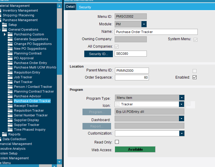

Have you tried going into the Menu Maintenance and checking the PO tracker menu indeed is set to launch the PO tracking program?
There is supposedly a known issue with this, PO tracker actually use Erp.UI,POEntry.dll and Epicor must have it programmed to know to open tracker version. Support confirmed this for 10.1.600.4
I will send our DB to the to get it fixed

I noticed this when we updated to 10.1.600 as well. All po tracker forms that we manually added to the menu no longer worked. Looking in the Ice.Menu table I noticed that the POTracker dll is no longer used rather it’s an argument to the POEntry dll now. -formName POTrackerForm needs to be added to the menu item in order to get it to open POTracker. If you are able to query the database you cane use the bellow select to see which records need to be updated. Alternatively you could also use a BAQ.
SELECT * FROM Ice.Menu WHERE Program LIKE '%POEntry%'

The trackers don’t use a different DLL. They use the same one as POEntry with different arguments to specify which for it’s using. the Tracker form needs -formName POTrackerForm in the arguments field.

In menu maintenance, you will set the customization there. All that does is add another part to the to the argument starting with -c. There can be more than one argument.
