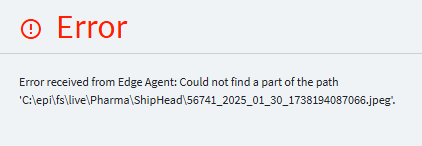

We are on the latest version 2024.2.7 in the cloud and use EKW - stores personnel save POD signatures and for quality purposes are now saving photos via the app - both are saving fine to our cloud drive ie: C:\epi\fs\live which translates to Y:\Live\Pharma\ShipHead on our windows explorer drive (once the powershell script is run) but for users who don’t have access to this drive I want them to be able to view or download the attachments directly from customer shipment tracker but currently getting this error which I think from other posts might mean they haven’t got the edge agent side working yet?? . If the files are saving correctly and we can open them up from the cloud drive how does the attachment link do the same?.. If anyone knows the answer it would be greatly appreciated Thanks

The Edge agent is looking at the clients C drive, this is why it is erroring, so unless they have access to the y:\ it won’t work from customer shipment tracker.

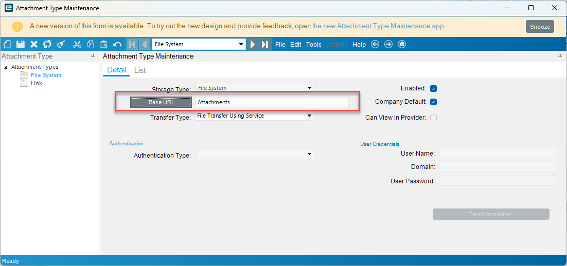

The only other way I can think would be to be using a UNC as the Base URI for the Attachment Type. However this may not be an option in cloud.

Final update after a meeting with Biscit - as like with bartender the base url for the cloud drive / folder needs to be specified as so that the POD documents can be viewed or downloaded.
\tenantid.file.core.windows.net\tenantid
