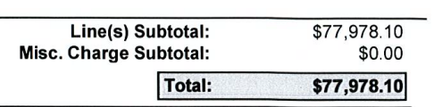

Another example, with old scan archive of the PO form vs now when it generates:
It isn’t a reporting issue, the cost data is not in the database…!
