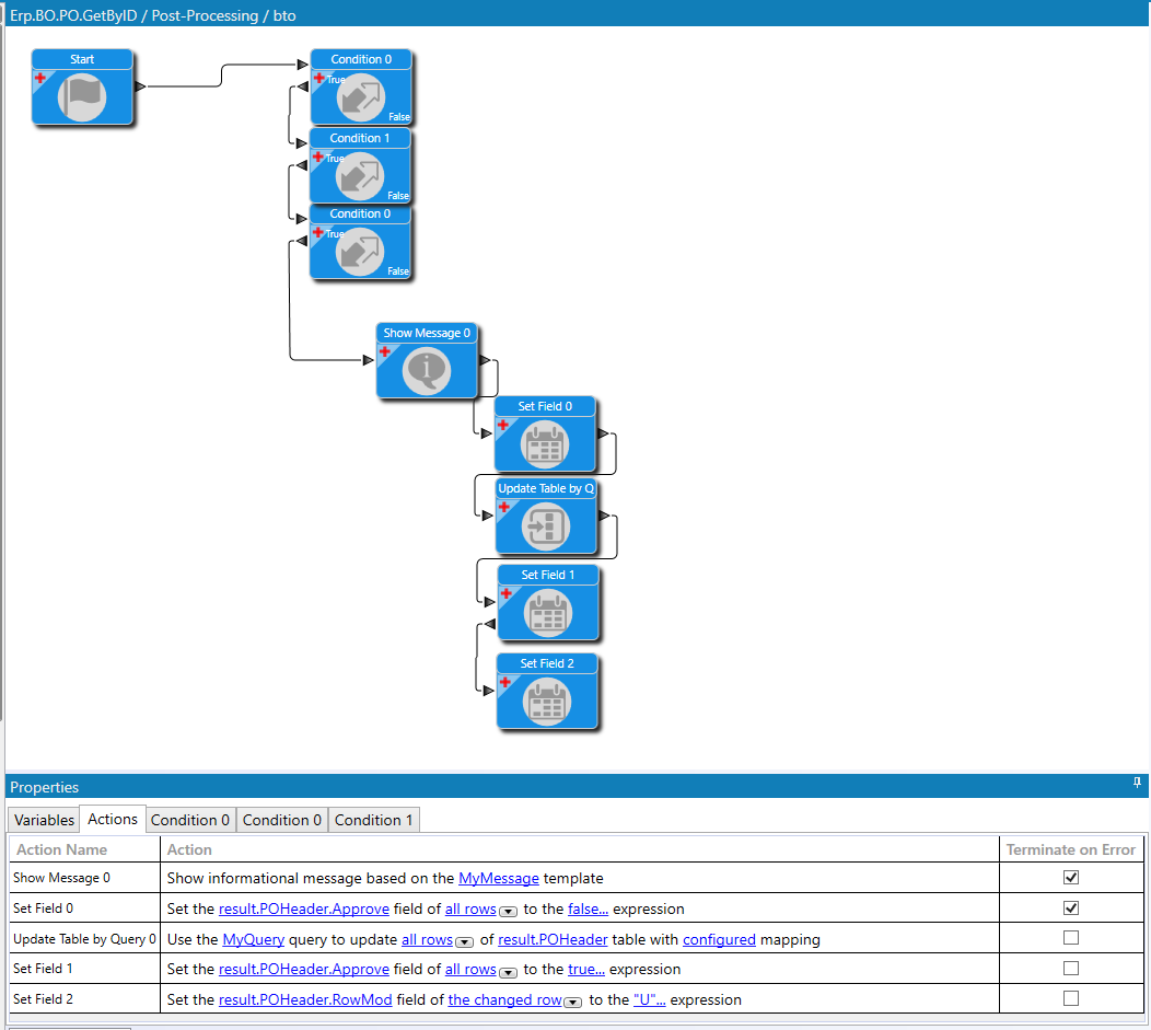

I created a Post-Processing Method Directive BPM (the BO is PO and the method used is GetByID). The goal of this BPM is to print a comment in the POHeader.CommentText if several conditions are triggered.

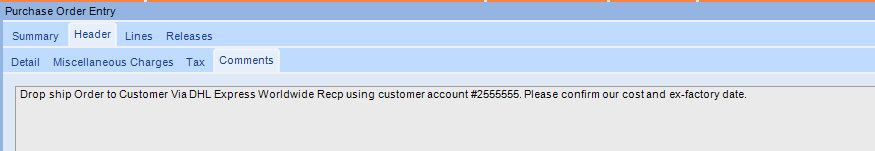

The correct sentence does get printed in the Comment Text section of the POHeader tab but when I do a print preview of this PO or when I run a BAQ for this PO then this comment does not show up on either of this.
My Question is what am I missing in my BPM for these comments to actually show up in my BAQs and in my print preview ?
post processing is server to client, but without the user making another change and saving that data is not getting saved. You need to be preprocessing or in transaction to save.
What is the user supposed to be doing to get this comment to appear?

I cannot get this BPM to trigger when going the preprocessing route. Maybe you have pointers on how I could achieve this ?

I believe you have have to use Post on the Get methods - anything changed in Pre gets overwritten by whatever is in the DB when the GetByID is executed, unless you make sure your changes are written to the DB.
In your Post BPM, you could make your change, call Update, then Get again - but you have to make sure your conditions are good so that it doesn’t get you into an infinite loop - and so that it doesn’t do the Update/Get when you don’t need it to.
Probably better to have this updated when the condition you’re looking for happens: Update your POHeader as soon as you know you need it (on Update, check for those conditions, for example)
