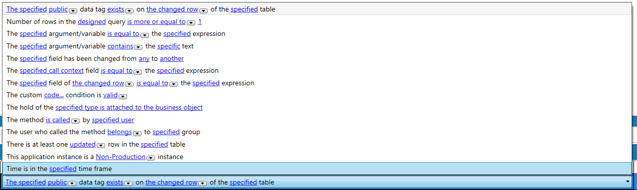

How can i make the condition so it looks at a fields value.
I need to make a pop-up that alerts the user the Currency Code on a Quote is not a certain value

Did you mean when Customer Currency Code and Quote Currency does not match then alert?
Hi,
Nope i just want it to read the quote currency code and if its not in GBP then to show a message
You can do this at method directive → Quote → Update → Pre-Processing. Use condition widget as QuoteHed.CurrencyCode is not equal to GBP, show a message!
This will sit on User’s nose till they match currency code to GBP ![]()
Under field use: CurrencyCode
then set not equal to
and under expression “GBP”
