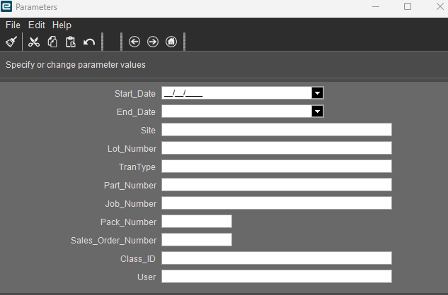

I have created a quick BAQ and deployed it to show a list of part trans. I have added several parameters, each with the “skip condition if empty” checked.
If no parameters are entered, it crashes the query because it is trying to call every trx ever made in the history of ever.
How can I either
1.) Add a pop up message that reminds the user to enter at least one parameter
or
2.) Require at least one parameter to be entered before system runs the query
Side note - the parameter fields are far too long, I have played with the format to shorten them up, doesn’t seem to be doing me any good. Ideas on that?
2025-05-01_104011
