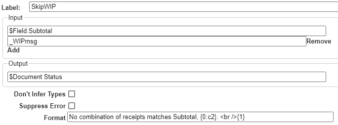

Found an example of this sort of thing here:

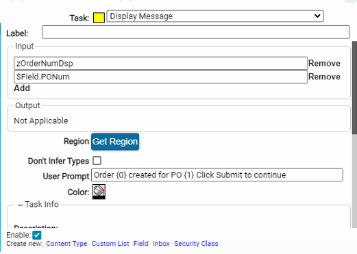

That message seems to work as intended when I go to an invoice at that step in the workflow (Select Receipts). However, every time I try and recreate this in the Display Message task, it displays “<br />” as text and keeps everything on the same line. (Even here, it starts a new line if I leave it as text haha)
Is this something that’s possible with that Task? Maybe I’m using the wrong syntax? I guess this isn’t the end of the world, I could always separate with a “|”, but just figured I would try and make it as convenient as possible.
I have attempted this a few times and could also never quite determine the syntax required. As a workaround, you can use the Advanced Format task to create an HTML formatted string of text and populate the $Document Status field with that output. Your display message can then tell the user to refer to the $Document Status for more details. The Display Message task would ideally allow for this same HTML formatting, but at this time I don’t think it works that way.

I was not able to populate $Document Status using Advanced Format at our last user prompt step of the Workflow. Instead, I had to use Advanced Math and use it in the Pre-Create and Validate Invoice step. Took a while to figure this one out, but I think this should work for us! Thank you for the suggestion!
