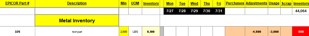

Attached is a snap shot of our current manual sheet. The first Inventory field never changes as its our months starting amount. the Inventory column on the far right changes when the warehouse manager moves raw materials to whatever department requests it. is there a way to do this in a BAQ?
