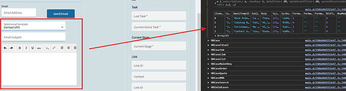

I am able to populate a combo box with the EmailTempID value for the user to select which template to use:
My problem now is I’m struggling to populate the rest of the fields, Subject and Body with the rows from the combo box.

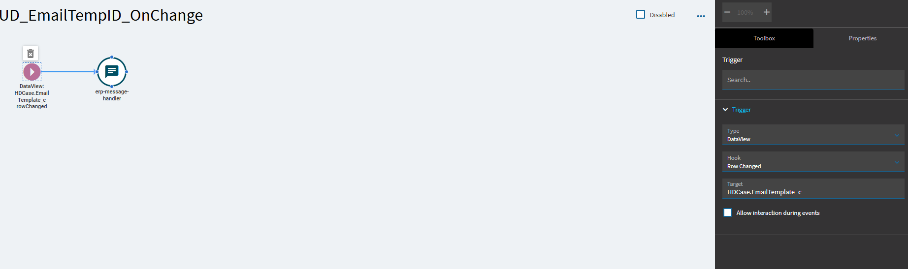

I tried an event for when the row changes, as I figured a DataView Row Changed event pointing at the EpiBinding would work:
But this event is not triggering when I look at the debug console.
Additionally, I’m not sure how I’d populate the fields based on the selection of the combo box value.

HDCase.EmailTemplate_c is a column, not a row.
Try using DataTable.ColumnChanged.
Welp I feel dumb, yep that works. Thanks Hannah.

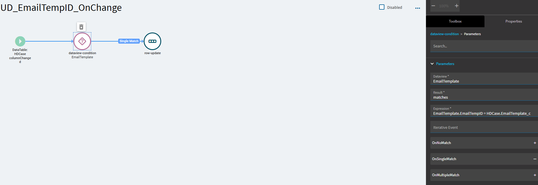

After banging my head for a bit I finally managed to make it work dynamically.
The key was using dataview-condition and then using the System Data View matches, then passing that to row-update.
Adding this in case someone else has issues working with DataViews as I did.
Solid learning experience. Thanks again Hannah.
