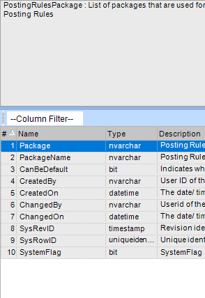

Are you using the PostingRulesPackage table? Can you link that to GLBook where Package = DefaultPackage?
Then you can get Company off of the GLBook table’s company column?
I state again… If the table being referenced, has no company column, the baq cannot know which company to pull. It’ll be wide open for that table.
What table doesn’t have a company column?
Whichever one @jkane was linking lol.
I guess that is my confusion . . . what is the baq looking at?
Assuming one of these:
They do not have Company as a column:

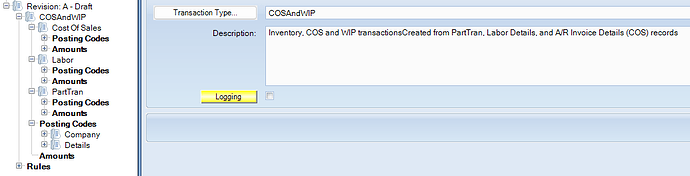

This is where I am at. GL Transaction Type Maintenance.
I did not expand any of the nodes, but under all of those, there is no field that stores Company.
