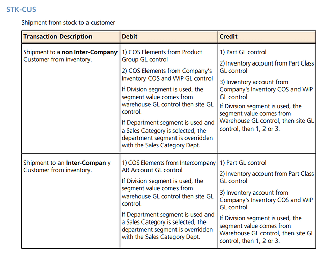

Oh, you are familiar with the Inventory Transaction Hierarchy tech ref guide, right?

OR you can cancel it fix the issue and rerun the capture. Below is from the transaction hierarchy which we all should have downloaded for reference.
