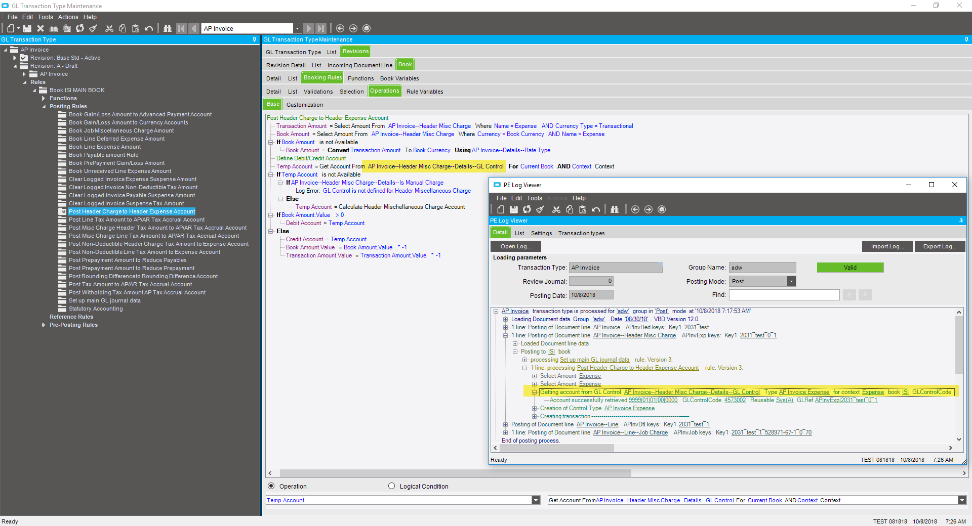

I have a request from the finance group to modify the posting rules in the following way:
This is all non-inventory items. I need the tax amount to follow the account on the PO or where we code it.
For inventory items there shouldn’t be any taxes, but if there are we should be expensing it to a specific purchase price variance account. We do not want taxes to be included in our inventory.
I have never messed with the posting rules before, but my boss is pushing for me to learn instead of relying on consulting. Can someone offer me some guidance? I got as far as finding them, but I’m a little lost within.
Well, I got this far using the PE Log Viewer.
Little lost as how to get the GL from the PO Release, however.
That does not seem to be one of the fields available. Am I restricted to those?

Aron, you´re on APInvoice rule. PORelease is not available there just the APClearing context.
To get PORelease you should look at Cost&WIP rule under PUR-UKN/PUR-STK transaction type.
