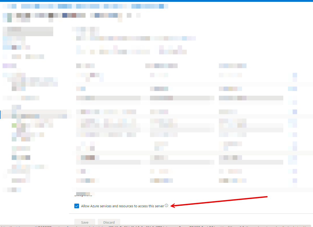

When you connect a SQL Db to Power BI you do so normally via a DataFlow which sucks the data out of the Db and puts it into the Power Platform the only thing you’d have to white list is giving the power platform access to that Db which (I believe Epicor already hosts these Db’s in Azure anyway is literally a check box on their side)

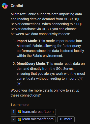

It’s still a little fresh (like Kinetic), but it appears that Microsoft Fabric can import OR query directly.
Connectivity to data warehousing - Microsoft Fabric | Microsoft Learn
