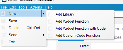

Found the actual Custom Code Functions part , but no custom code widgets for within the designer but I think should be good now that I got custom code I can access.
For anyone else having troubles to get custom code there are 2 ways one - Add custom code function or add widget function with code , the only way you get these is by doing file – New – Custom Code Function or Custom Widget with Code
