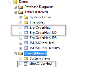

If you do use direct SQL there are views created that do this join for you. The tables used by the application are in the erp and ice schema but the views are in the dbo schema. So to get the equivalent of joining erp.orderhed to erp.orderhed_ud you can use dbo.OrderHed (view)
