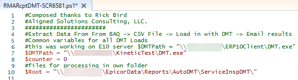

I am trying to run a test script within the pilot environment that accesses BAQ to pull out the information within csv. It works fine within the live environment but when it comes to testing within pilot environment, it causes a credential error. Please let me know if anyone else has this same issue before.

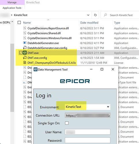

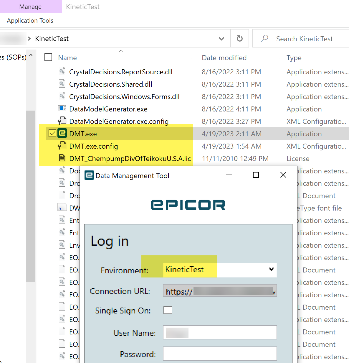

Hi Kim,
I am more business analyst than IT, but here’s what we did to make it work. Put the DMT tool in your test instance folder on the server, along with license and configuration file for it per screenshot. If you can run it from here manually on Pilot, then you can feed the DMT from PS script for the run.
Nancy
