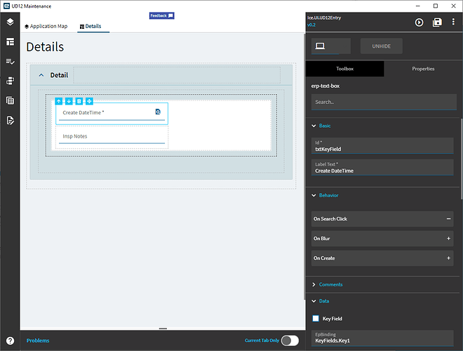

I am modifying the entry screen for UD12, which I will use for PPAP (part inspections, basically).
For simplicity, I think I would like to go with Key1 being set as the current date-time when the record is created.
Is there a way to do this in Application Studio? I am fairly new to this.
I guess it would be some kind of Event? If so, could you provide guidance on that? I’ve been poring over the guides but still can’t wrap my head around this.

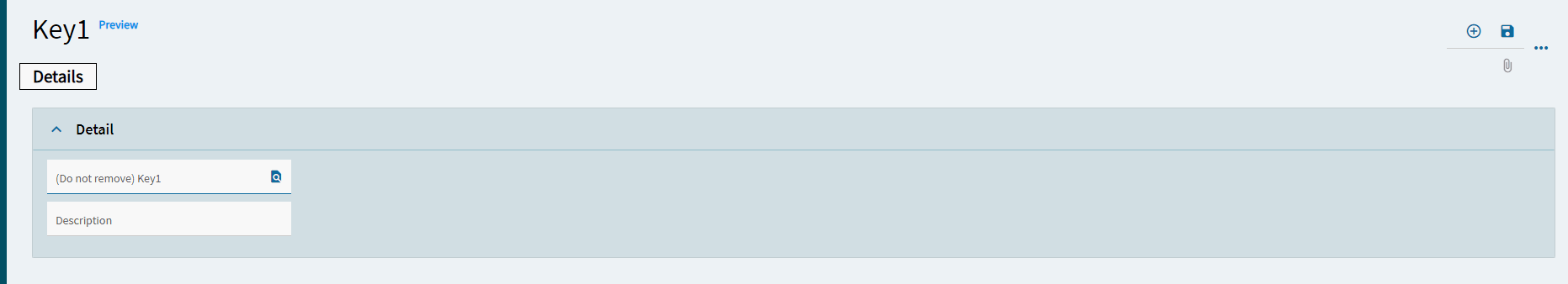

As if it was going to completely reformat the text in the header:
Both of those are Key1

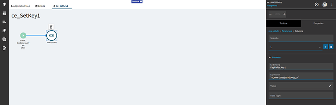

For educational purposes, you would create an event on a trigger (found via Dev Tools in the browser) that would call the row-update widget.
SetKey1

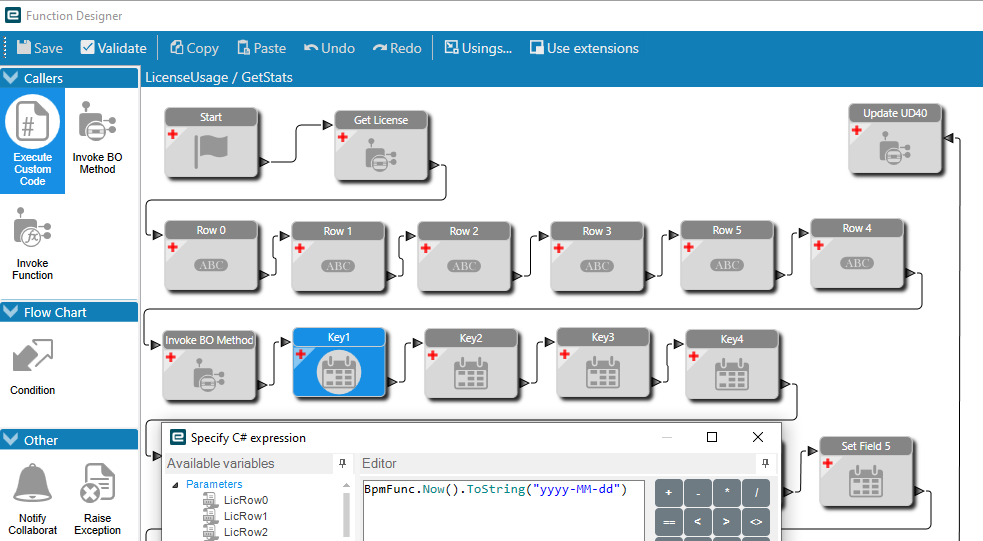

Yep, this part isn’t hard. I can do widgets all day, and I’ve already done something similar to this in a Function:

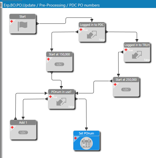

But, I certainly do have a very rudimentary “autonumber” BPM in place - for 3 years now. (The 2 rightmost widgets are new since January, though.)
To explain this, we have 2 main sites (plus a third; long story). I call them MFG and PDC. MFG was first and its POs are in the 300,000 range per company config (or maintenance or whatever).
When PDC came into the fold, I made them a site but wanted them to have their own PO numbers, and in fact they already did have their own, in the 100,000 range (around 143000 at the time). So to honor that, I made this BPM for users logged into the PDC site.

Any expression field can execute JavaScript by including #_<your code>_#
