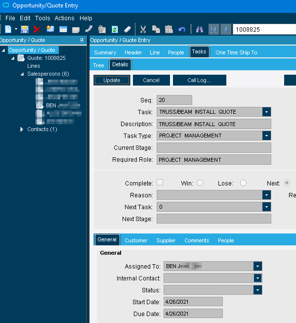

As we start to use Quote Tasks more, we discovered that lots of non-salespeople ‘salespeople’ have been added to quotes. We tracked it down to tasks - When you add a task, it seems Epicor adds the task person to quote as a sales person (person tab). This is making commissions messy.
Is this something in our configuration, or is it base Epicor behavior? I did a trace, and when you change a person on a task, the Quote.Update method fires.

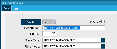

Task:

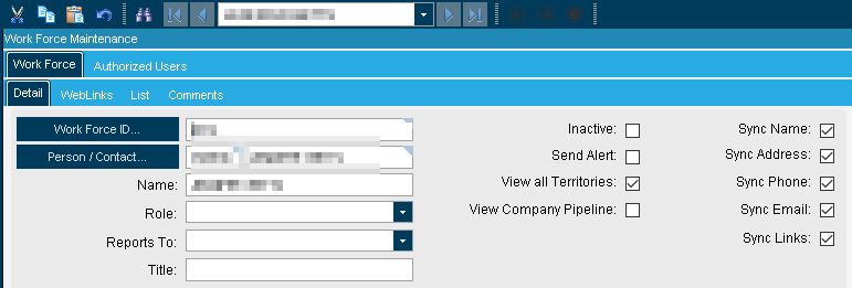

Workforce doesn’t have anything unusual for our non-salespeople:
Could the Roles under Workforce be used to segregate the salespeople from non-salespeople, then a BPM to prevent adding the non-salespeople as a task asignee?

Exactly. I edited my original post to be a more clear.

I put in EpiCare Case CS0002547477 - Task People Incorrectly Added to Quotes as Sales Reps, and the ultimate response was “working as designed since 9.05”. I don’t understand why you’d want to add everyone to the quote as a salesperson (i.e. the credit manager or the scheduler) .
I’ve even tried setting workforce and task roles to non-sales (aka set it to Credit or Project Management), but no matter what, a new person on a task is added to the quote as a new salesperson.
