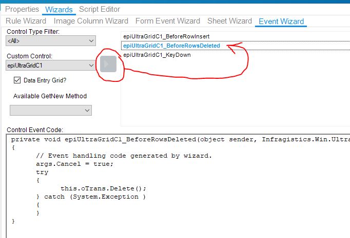

There is a BeforeRowDelete event where you can cancel the event.
It’s built right on the grid
Just go to events
Select your grid
Select DataEntryGrid
Pick a random GetNew
Then epicor will create 4 events you can delete the rest but the delete event you can use to either cancel the delete or invoke one of your functions

Thanks again Jose, that worked perfect!

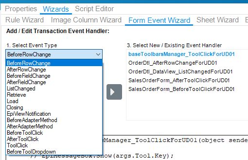

I am public cloud (not yet live, so in our test environment), so we are on 10.2.600.4. In the Form Event Wizard, I do not see the BeforeRowDelete event. @josecgomez has this changed?
FormEventWizard

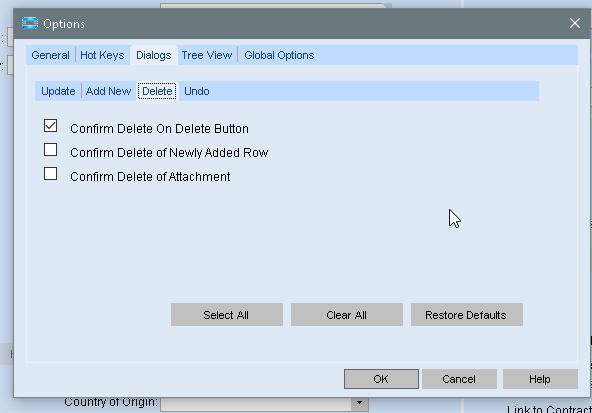

With a test account (that has no ability to change any column in the child table), I was able to delete the row without the “Delete Confirmation” popup. @ckrusen did something change on this too?
That is still there you need to select Data Entry Checkbox on the Events Tab (not the Form Event Wizard)
Did you check your options settings for that form?
@josecgomez thank you for clarifying. I found it here:
EventWizardBeforeRowDelete
Now it looks like I will need to write some code (my weakness).
I think I would need to verify the user group and if the user is not a member of a particular group, disallow and display a popup that states, you are not authorized to delete this information. How would that code look?
Also, the buttons “Update All Event Code” or “Update Selected Event Code”; are they referring to “all” as the three custom codes and “Selected” as only the blue highlighted custom control (in my picture epiUltraGirceC1_BeforeRowsDeleted)?

Calvin,
Yes, confirm Delete is checked.
OptionsConfirmOnDelete
With the 2nd option (“Confirm Delete of newly added row”) unchecked. You will not get the dialog if it is a row that has been added, but not yet saved.
