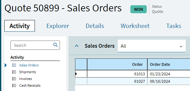

It even displays correctly (based on a quick test in my PILOT):
You would need to develop a directive to warn/block this functionality. Something against the ERP.BO.QuoteSvc, CreateOrderFromQuote.
In your directive you could check to see if an OrderDtl record exists with the quote number and line in OrderDtl.QuoteNum and OrderDtl.QuoteLine. If one exists, pop an error message.
